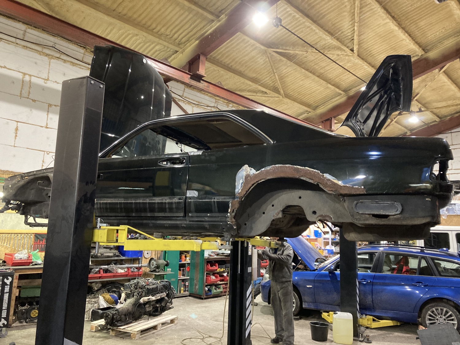

I found this site when searching the VIN of my SEC in google. It was very nice to find old photos of the car here. I bought it last year from Lithuania, just wanted to share that this car is still alive and is being fully restored. Had to clean up the work that was shown here on page 13
I thought maybe some of you might reckognize this car from 10 years in the past and could find this interesting.
I bought it last summer and wanted to enjoy it a bit before taking it all apart.
Almost killed myself, the right front brake caliper bolt came out and got caught in the wheel and stopped while driving 80km/h.
Then the EZL ignition module died, had to find a used one. Later the fan clutch went kaboom and destroyed the radiator.

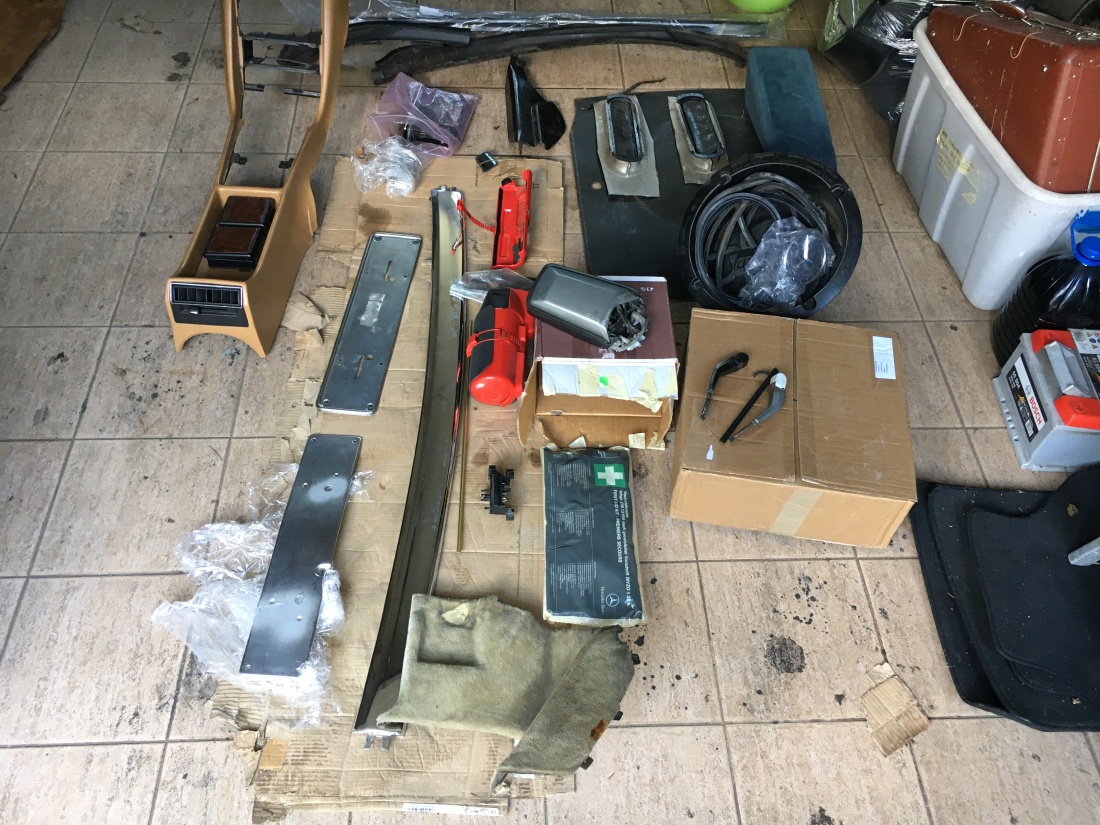

I started gathering parts for restoration and upgrades. I will be adding air conditioning.
Night cruise, god the car is so sexy

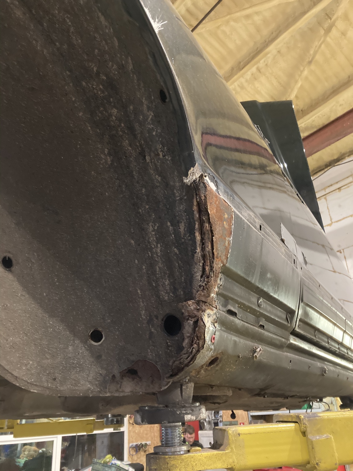

The front and back fenders were totally destroyed, there was more fiberglass than metal. Had to order good used fenders from Ukraine.

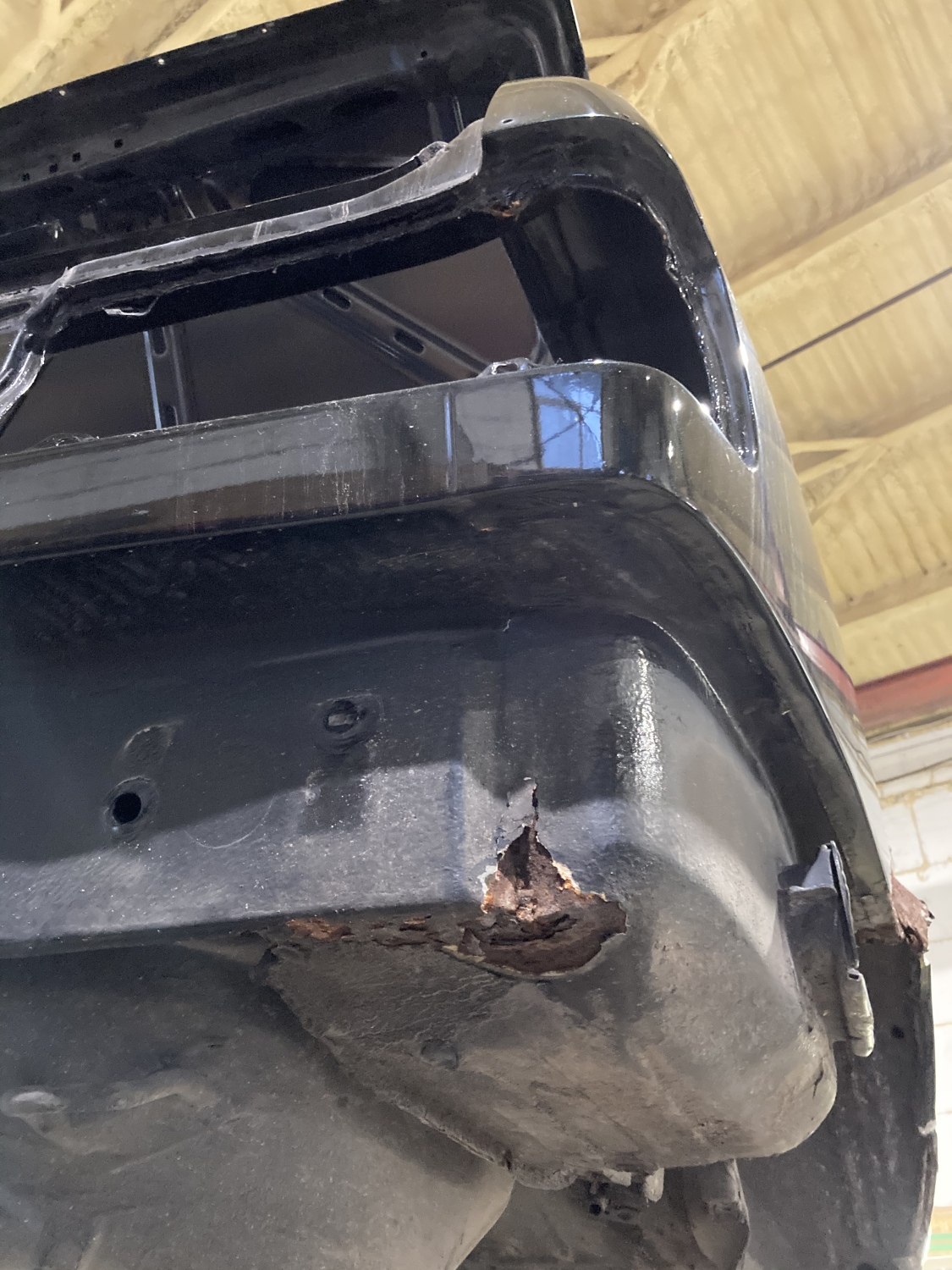

There is a lot of damage on the body, the rear part has been in a slight accident and was repaired poorly. Some spots have more than 6mm of body filler.
Lots of wires

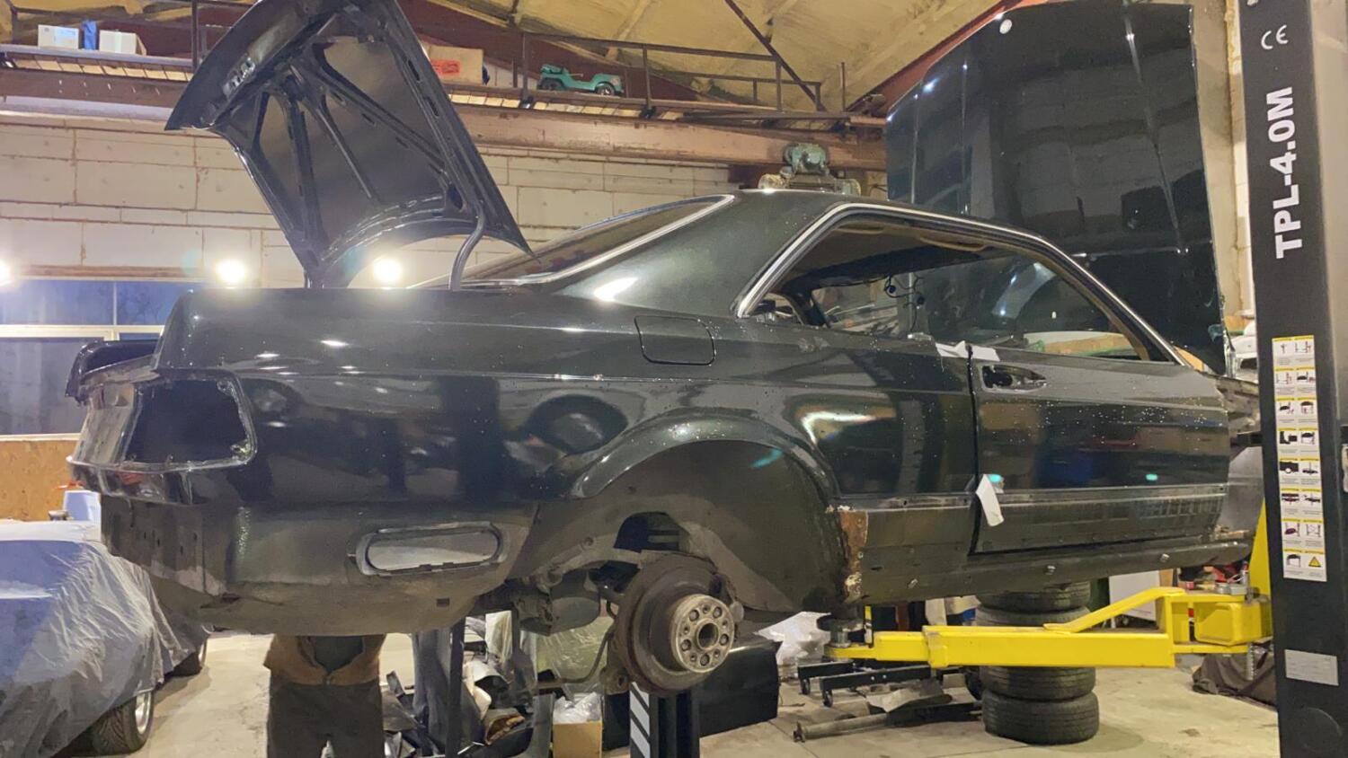

Stripping it down
Few small videos with rust damage and fiberglass.
https://www.youtube.com/watch?v=oFJlg0It_Pk
https://www.youtube.com/watch?v=2tl2JZMrFrg
https://www.youtube.com/watch?v=ACFprT_iXj8

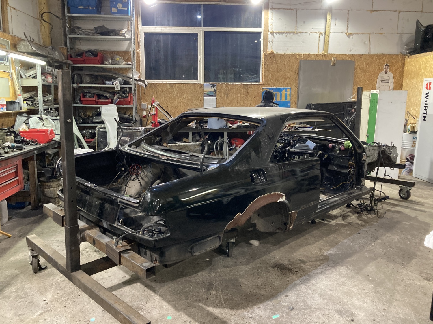

Further disassembly. Every single part was removed, the shell is now on a rotiserrie and is being restored.
The fiberglass repair peeled off in one piece.
All of the undercoating was removed

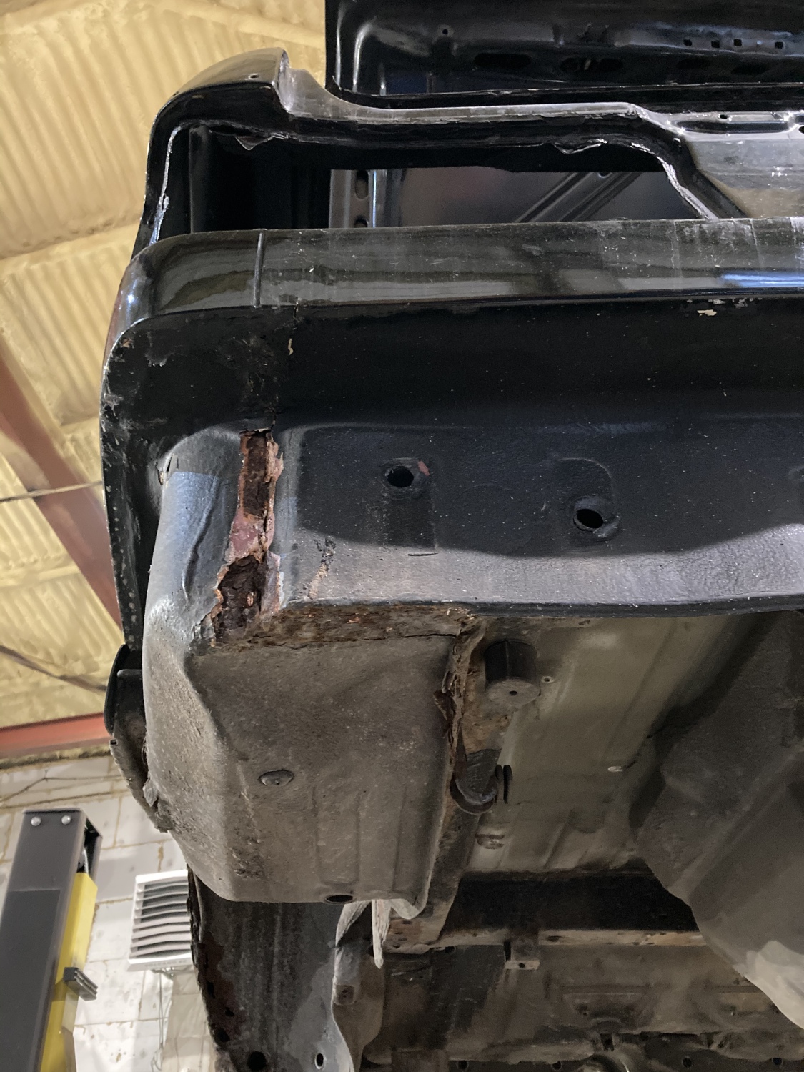

Rear corner next to trunk lid, you can see the thickness of body filler
Front frame mount
This was completely eaten by rust. Created from scratch.
Suspension powdercoated
Hope you found it entertaining. Keep these great cars alive
